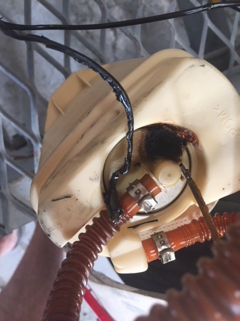

No errors displayed on Durametric. No fuel pressure. Fuse ok, jumped pump relay made no difference. I drained the tank and pulled the pump.
Wow. All insulation burned off one wire. Wire itself dangling free, not connected to pump as the pump electrode melted through and detached. All plastic near the electrode melted to a black crisp on the top of the pump body. Amazing this much current could do this damage without burning through a 30A fuse or a relay. No detritus in the tank, but the rubber seal around the top had turned to black goo.
How did this thing not torch itself? I was very lucky.
Will post pictures later.
I kind of expected this; your pump looks like it has been overheated.  People forget that the pumps are cooled by the fuel around them, so consistently, or even purposely running the car very low on fuel can lead to this exact problem.  And by-the-by, this issue is common to all in tank fuel pumps, not just Porsches.
Wow, that's extreme and I agree you are lucky.
My guess is some debris got sucked into the pump and almost seized it completely. The bump will draw a lot of current in that case. Will be interesting to remove the pump and check if it's seized. There should be a teabag filter at the inlet. Also make sure the fuel tank bottom is free of debris.

Tank is clean inside, except for a few tiny, broken zip ties. Screen on the bottom of the tank is discolored, but not plugged. This may be a good reason to keep the tank topped up. Comparatively speaking, this has been easy to do (unless I damage the fuel level sender when I reinstall it).  I suspect as the entire car was a study in deferred maintenance, the fuel filter may also have had something to do with its demise.
