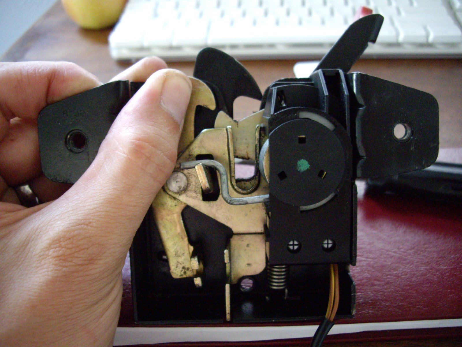

I pulled mine out and have some questions as the photos showed below.
Photo 1. When I pushed the latch down with a screw driver, it seem to be closed.
Photo 2. When let go the screw driver or press the release switch, seems like the latch did not open all the way?
Photo 3. How the latch look after push a bit manually
Is this something normal or means the cable is loose?
Share this post
I seem to find the problem on my hood latch. When the latch engaged, it didn't seem the release cable pull far enough to release the hood. I wonder if there any ways to adjust the cable?

My front hood had been stuck closed for a while. Pulling on the regular lever didn't produce the normal release, and no matter how hard I pulled it up, it wouldn't open.
I took the front passenger wheel off this weekend, removed the well lining, and found the emergency release cable. After a few hard yanks on that, I was able to get my fingers under the hood, and open it. One of the problems, I believe, was that the hood was not being raised at all upon release of the catch.
I've now got the latch out, but can't really see what is wrong with it. Possibly the spring does not have the right tension. Can anyone tell from the pictures what could be wrong with it? I know, that sounds a little silly, and I'm sure I'll have to take it into my local parts place for them to look at. I don't really want to spend $150 to replace a part that (at least on the surface) looks to have very little wrong with it...

Ok, I'm a new 1999 996 owner and this website has been invaluable!!
I'm having this same issue and I took the latch out, the spring was in the little hole and in the catch arm. It seems like the spring doesn't have enough tension. How can this be fixed? I used some LI grease on the spring but that didn't help either. Any and all help will be greatly appreciated.

I have this exact same problem in my 2001 996. After replacing the latch with no change, I think it could be the latch motor by the drivers headlight that is weak and not pulling the release cable far enough to pop the latch mechanism. I have ordered a replacement motor and hopefully that will fix it.
Share this post
So my front trunk latch is fixed - it was the actuator. I got a replacement from Suncoast for around $60 and it opens every time now.
