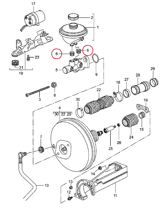

I'm bleeding my brakes on my 2003 Boxster S for the first time. Using the Motive power bleeder and bottles, everything in general is going well except......I noticed the brake fluid reservoir is now slowly leaking fluid from the bottom. I did not exceed 20 psi using the power bleeder. Any thoughts? Is there a way to tighten it? I hope I don't have to flush all my new fluid out, as I usesd Motul 600, and it ain't cheap.
It just sits in two rubber(like) gaskets.
Yes....I see those and that appears to be where the leak is. After several hours of sitting, it does not appear to leak. But if I take it out for a drive, there are a few drops of fluid underneath the reservoir. Any ideas?
Thanks,
Kevin
Thanks,
Kevin
Well, it is most likely either a cracked reservoir or bad gasket. Chances are you will need to take it off to inspect it.
I use a large hypodermic needle to withdraw the brake fluid and put it a clean container so it can be reused.
Thanks Loren. I bet I cracked the reservoir when I was connecting/disconnecting the bleeder. It's not mounted in a very sturdy fashion, and I probably tried a little to hard to prevent air leaks by torquing the cap to much. Guess that's a lesson for the future: be sure I support the reservoir with one hand while removing the cap with the other. I didn't realize it was that delicate. Hope they will sell me the reservoir without buying the entire master cylinder.
Kevin
Kevin
Yes, they should sell you just the plastic part. About $40 MSRP as I recall.
Make sure you get the right one for your car because they are different.
Kevin
Hey Loren - I cleaned up the brake fluid really good, and let the car sit Sunday and Monday. No leaks. I took it out for a drive (carefully) and did some hard braking. The brakes work great. And no leaks or drips, or even a hint of fluid leaking.
The only thing I can think of is this: When the reservoir was pressured up by the power bleeder, I hit or twisted the reservoir, hard enough for some fluid to squirt out by the gaskets for a moment. Is this possible? Does the reservoir just sit in the gaskets, it's not bolted or screwed on?
Thanks,
Kevin
Kevin
Thanks,
Kevin
That is correct - it is not bolted on just the gaskets.
I would just check it daily for a week or two and if the fluid level stays up and there are no leaks - then chances are you just momentarily broke the seal.
