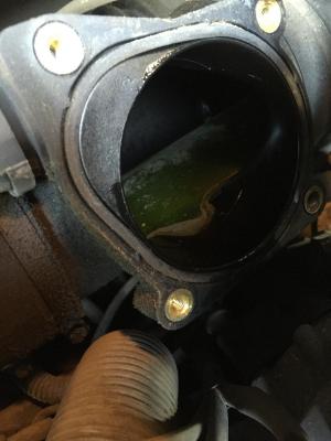

Ok, I have spent countless hours studying this issue on multiple web sites and books trying to figure out my new coolant in oil problem.  Yes, I understand it is probably my worst fear, but this occurred in such odd circumstances.  1999 C2 -87,000 mile - oil changes every 3000-4000 with Joe Gibbs oil (since 45,000 mile purchase) - I pull the oil sump off every other oil change and look around (IMS fears), inspect the filter in detail every change - always  perfectly clean - almost too clean!
I had the vehicle up on jacks doing other work, completed an oil/filter change - ran it on the jacks for 3-5 minutes, topped the oil off and then left the vehicle there for about 2 months while I was out of town.  Came back, started car, moderate miss in one cylinder and smoke out the pipe, but it was quickly clearing up (smoke and miss) as it started to warm.  Shut off, pulled vehicle off of jacks, checked oil - noticed an 1/8" high to what I know was an exact fill (jacks and ground level)  Thinking I must have screwed up on fill 2 months back, I reset the mis code and restarted.  Mis and smoke very light and almost gone, it did pull a mis code- let it warm up for 5 minutes - mis and smoke gone now and shut down.  Checked oil - 1/2" or more high, checked coolant - yes - low and also got the coolant low light. Obviously expecting the worse case scenario, even though the vehicle was only run a very short time without load on both occasions.   Performed vacuum leak check on coolant tank, it leaked so bad/fast, I could not get any location indications.  Drained fresh, but now chocolate milk oil and pulled sump to look around.   Drained coolant and NO evidence of oil mix!  I had to leave car for a month, but got back and performed a leakdown test.  1 and 6 had a 25% leakage (still in green), but clearly one was exhaust and one intake.  2,3,4,5 were tight, virtually no leakdown.  Engine was cold, so not the best test.
I am totally confused.  This engine dumped one to two quarts of coolant in oil in those three short 3-5 minute no load runs and yet my leakdown test seems to show no cracked head, D chunking, etc.  (unless the crack did not reopen with the cold engine).  Before I tear into things, is it possible that the oil cooler could do this one way leak?  I understand the oil vs. coolant pressure difference.  Or in all my reading, I still cannot determine if there are coolant lines on the top AOS where a diaphram might let go on this model.
Could I be that lucky?  I doubt it, but what am I missing here guys?  Any experienced thoughts?  My next call will be to Raby I guess.
Thanks,  Jim

You have three possible ways to get coolant into the oil: 1. A crack somewhere in the cylinder heads or engine case; which you appear to have eliminated with your leak down.  2.  Your oil cooler may have failed (it is an oil to coolant heat exchanger), which can be tested by pulling it and running a vacuum test on it (if it is good, both channels should hold high vacuum).  3. Your AOS.

In general, your thoughts about a failing cooler leading to oil in the coolant are correct, but when you shut the car off, there is no oil pressure but there is about 18 PSIG of coolant pressure so it can also go the other way, albeit slower.
As for the AOS, you can pressurize the coolant system to 18 PSIG and pull both hoses off the AOS, and you should hear or feel a leak.
A bad AOS usually makes a lot of smoke on startup. I have changed 2 myself in my cars. One smoked badly, the other just had high oil levels and low coolant
The AOS replacement will be a slow process with limited time, but I guess this photo inside the plenum after throttle body removal confirms the AOS dumped coolant instead of a cracked head or bad head gasket (along with the previous leakdown test).     In the future with a potential AOS failure or coolant in the oil, this would be one of the first easy things I look for: pop open the throttle body and look for coolant in the plenum.
So the AOS not only dumps lots of coolant into the crankcase, but also sucks it into the engine plenum.  Sure would like to eliminate this from happening in the future.  What problems would occur by not allowing the coolant flow through the AOS?
Not a fun thing to see......
