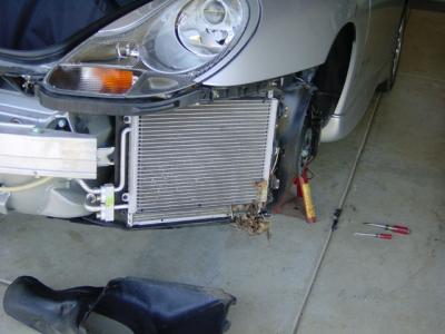

While replacing the expansion tank cap is important if you have the older "00" cap, the real culprit in a car running hot is the radiators being clogged with road debris.
I recommend every 2-3 years that you take the front bumper cover off and clean off the radiators. You would be amazed at the stuff that gets lodged in there.
Just reaching in and getting the debris out is not enough. The issue is that stuff gets clogged between the air conditioner condenser and the engine radiator. This reduces the airflow through both parts and makes the car run hotter.
Here are some pictures from a recent radiator cleaning of my neighbors 99 996.

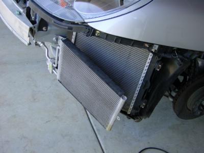

2. Yes as a matter of course you clean both sides of both radiators on both sides. The front radiator is the air conditioner condenser, and the back one is the engine coolant radiator. There are 2 sets of these, one on each side. Some cars have a 3rd radiator in the center of the front of the car as well.
You must pull apart the 2 radiators to get the gunk that accumulates between them. There is not so much stuff that sticks to the back of the coolant radiator because it all gets blown out (sucked out by the fans too) through the air exhaust duct.
This picture shows the air conditioner condenser and the coolant radiator pulled apart.

That last picture posted by Orient....is that the radiator that's actually BEHIND the AC evaporator? That gunk is what was sandwiched BETWEEN the radiator and the AC evaporator? Or is that just what's on the front of the radiator?

Yes, that is the water radiator - Gary (Orient Express) has moved the AC condenser out of the way.
The condenser and the radiator don't match up - so there is a gap at the bottom where stuff can get in behind the condenser.
Yes, as Gary suggests removing the bumper, the air ducts and cleaning the condenser and radiator behind every couple of years is highly recommended.
Yes, the majority of the gunk is between the evaporator and the radiator. There will be debris on the front of the evaporator too, but most of it is between the 2.
I've been routinely cleaning off the radiator (or is it the evaporator) that you can see if you shine a flashlight into the front cirbers of the grill...and am using a vacuum with a long narrow fixture to clean it all out.....but are you saying that behind what I can see in there is potentially another accumulation of crud sandwiched in between the radiator and the evaporator?
Yes, most of the stuff is between the 2 and the only way to clean it out is to peel the two parts apart and wash in there

I was having a similar problem with the temp gauge moving up to the middle of the 0 in 180 in city driving. I double-checked the cap and made sure the fans were working. Then today, I decided to finally take the bumper cover off an clean the radiators. Wow, there was so much junk in there, I couldn't believe it. Vacumed it out, put everthing back together and I'm back to rock solid straight up right between the 8 and the 0.

Loren and I did this same thing today...took off the front bumper and cleaned out the area between the radiators and the condenser....I had been vacuuming the front of the condenser and thought that everything was clean in there. I was really surprised when Loren took off the bumber and I saw all the crud sandwiched in between the them. We didn't have to take off the wheels, but there are quite a few phillips screws in a number of hard to see locations that you have to take off. I would have missed a few of them, but Loren knew where they all were.
