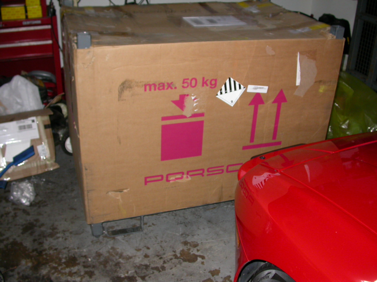

Yep I'm doing another engine swap, can we say X-51?
Well you are probably all getting bored with all the engines my poor car has received. But I couldn't resist a good price on a brand new X-51 3.6 even if my current 3.6 only has ~15k miles on it.
It should be here on Friday.
Todd

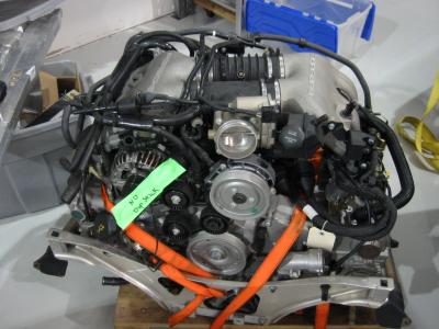

Eventually we will get to an X51 3.8. The process of physically fitting the motor is really not much different than any of the other engines that have been in there. The limiting factor on these larger motors is getting a proper exhaust to work with the larger displacement motors as the largest of the aftermarket systems for the boxster are designed for the 3.2. With the X51 I am going to try and modify the stock X51 headers to work.

are you sure it replaces the pistons. I was under the impression it is just a top end kit.
According to the Tech Bulletin

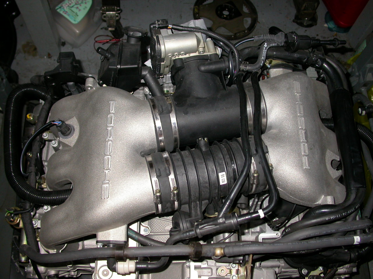

-new intake manifolds with modified cross-section and made of cast aluminum
new intake pipe supports
new exhaust manifolds with larger cross section and optimized flow
new cylinder heads with optimized CNC milled inlet ports
new camshafts with larger valve stroke on inlet side and modified inlet an outlet timing
new intake valve springs to account for longer stroke
modified partition box in oil pan
new DME maps
additional center rad
That is why you can add it after the fact to a normal 3.6 motor. It will be interesting to compare as the dyno curve shows you loose some low end torque to gain the top end increases.
And don't worry, it is getting a new performance clutch and lightweight flywheel.
Todd
Edited by tholyoak
Todd,
What intake manifold will you use with the X-51? Will the X one fit under the Box sheet metal or will you end up bolting a Boxster piece on?

It will use the X51 engine as it is configured. The X51 doesn't add any torque acccording to Porsche, and my trans has had no issues with all the miles with the 3.4 and 3.6 engines already so I'm not worried about it. I am sure if you like to drag race or do smokey burnouts that the trans would have a short lifespan, even with the 2.5 .
