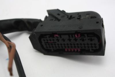

Looking at your little sheet you don't seem to realize that there are 26 pins on each of the old instrument connectors and 32 on each of the new ones. You also don't seem to realize how much work this was for me to figure all of this out.
For the pin removal/ installation for the cluster connectors you don't actually need any special tools, just remove the outer coloured casing and it is quite obvious how to remove the pins with a small pin or screwdriver.
