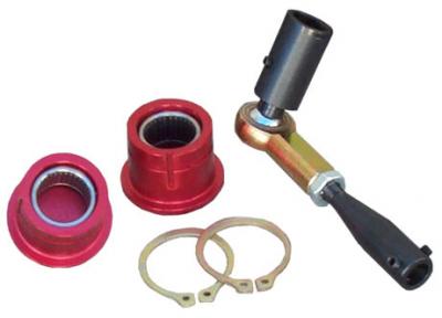

Evo has a short shift. It shortens the shift throws by adding an extension piece to the bottom of the stock shift lever. It is shorter than the 997/987 standard shift, but not as short as a B&M. And if you do not like it you can simply remove the extension piece.
This is a picture of the kit. The extension piece is the gold/black thing on the right. The kit comes with 2 red metal bearings to replace the stock plastic bushings, but you do not have to use the bearings. In the old days you had to pay extra for the bearings, but now they are included when you buy the extension.

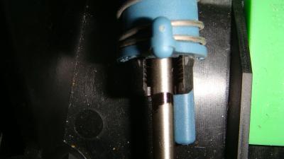

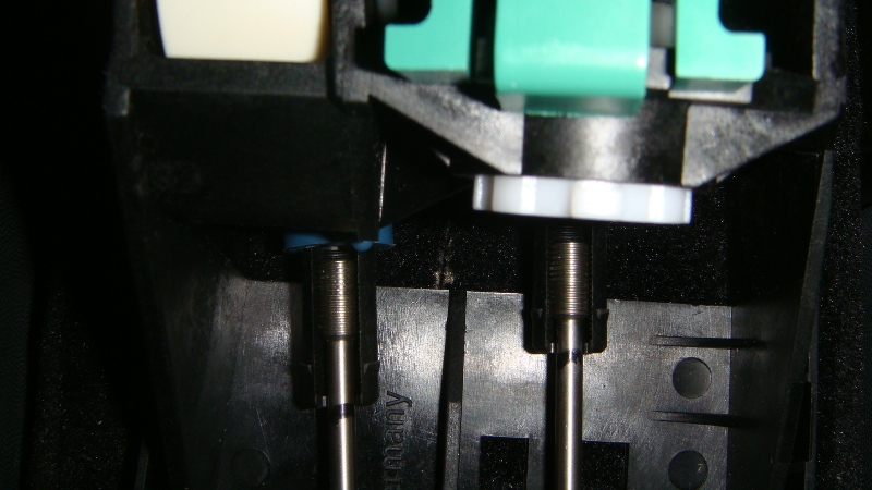

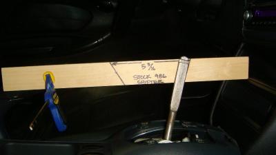

Clickman, here are the photos of my install.

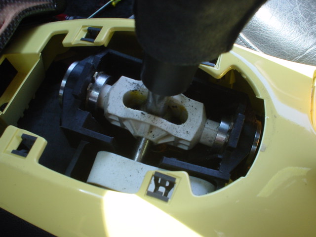

once you get the console removed (B&M instructions) you will be staring at your shifter assembly.

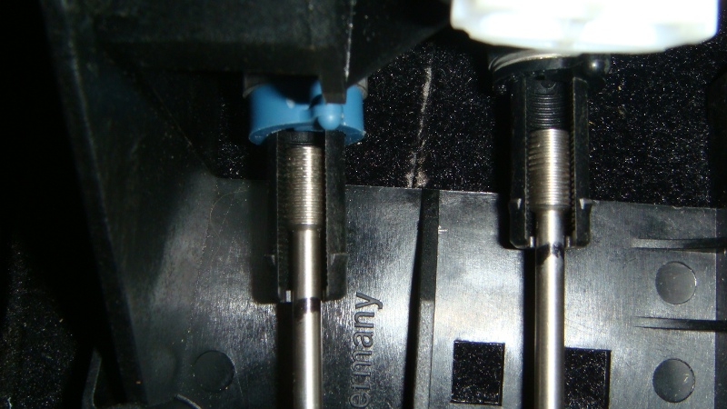

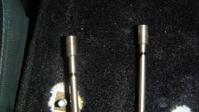

I marked the cables at the end of each shift link connections.
next, I removed the original assembly and popped out the cables from the sockets.

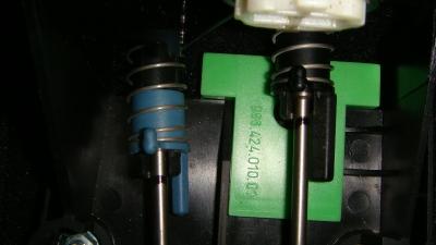

now it was time to install the new shift assy.
With the "green" shift tool in place snap the cable ends in place.
Note: I had to pull the left cable into place a little to match the marks, they just did not align perfectly with the tool in place. Probably about 3/16 difference.
I should have taken a picture of it (sorry). but it was not difficult.
next , lock the cables into place and test out your shifter before you put everything back together.
Now for the results:

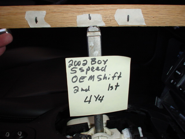

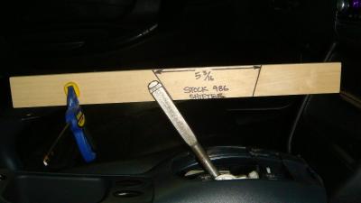

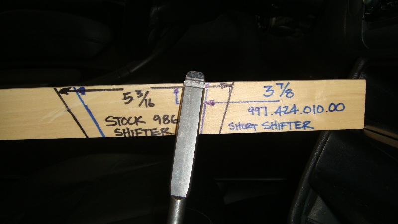

original shifter throw measured from the top of the stick. I measured from this point of reference because thats where the shift know would located in your hand. (2nd and 4th)
Here is the difference. Again measured from the top of the stick. FYI, the stick was in the same position clamped to the hand brake.
The "black" lines are the original, the "blue" lines are the new shifter.
Now, was it worth it for $161.00, I think so. I did not want to do the shift kit and it was way eaiser and less expensive.
I also like the way it shifts, not that much play in the throws. it goes into 1st a little eaiser on the downshift for me.
one last thing, it doesn't wiggle that much in netural either.
Hi TP, thanks for the suggestion. I checked it out on the Pelican site (and one other): the Evo "Swift Shift" claims a 20-30% shorter throw. The stock 9x7 shifter is basically the same, at 25%, based on the measurements Halo made.
It seems like the only way to find out is try one. If I do install a SSK, are the bushings that come with it able to be used on the stock shifter if I want to go back?
Thanks
Share this post
If you are talking about the EVO unit then you would install just the extention piece. It attaches with set screws so you can take it off if you don't like it. If you like it and want to install the bearing that come with the kit then you have to break/remove the oem white plastic bushings. The EVO bearings fit the oem shift lever.
As I said, in the old days the kit only had the extension piece. And that is all we put in, unless the owner also purchased the optional bearings. Picture shows the bearings installed on the oem shift Back then they were silver - now red. You cannot see the extension piece in the picture.
Share this post

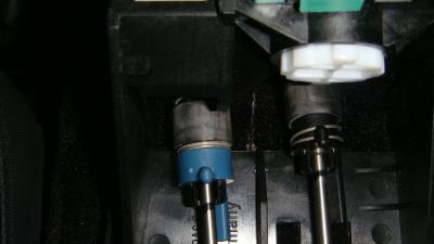

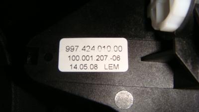

I just installed 997-424-010 shifter into my 01 5 speed boxster. in reading this thread, I deviated in the installation of the left cable.
I did mark the cable end/adjuster before removing my old shifter. but when it came time to re-attach the cable to the new shifter's adjuster, I did not pull on the cable to re-algn the mark as stated in Halo's description/photo instruction. I figure that the cables being attached to the transmission is at it's desired location; neutral (fore/aft) and at the 3-4 gear selection (side to side). Also assumed that the green tool that comes attached to the shift lever is holding the shifter at center.
should I have pulled the left cable up to the originally marked spot?

You can never go wrong if mark the cables or count the threads and then put them back where they came from. (Unless, of course, it was not adjusted correctly in the first place -- but you would notice that).

Make sure you put the alignment tool on the right way as it can go on from both sides and gives different results. I marked the cables and used the tool (just in case) and did not have to pull any cables. When I think back I might have pulled just a little on the right one, but just a little - and by hand.
Put the tool on from the right side, so that the opening is to the left. Also; it's a different alignment tool when using the standard 9x7 shifter from the SS. I think my tool was white. SS one is green.

The green alignment tool was positioned with the opening towards the left per ATTA’s posting.
Little more description of my installation thinking - not restoring cable to adjuster at the marked points.
I assume that the tool kept the lever at the center, both fore/back and left/right such that equal tilt equal travel; simple trig. If you pull the cable align marks, then with the tool removed, the shift lever would have an offset , left/right or front/back depending on which cable was pulled or pushed..
This offset will induce unequal throw from neutral position, nominal 3-4 gate (5 speed) to gears. Throw to 1st may be longer than throw from neutral to 2nd. Similarly for left/right gates.

SB01box,
I aligned the cables with the tool in place. The green tool was already in place when I opened the box.
I left it in that postion (opening towards left). A little pull, not much, was used to align marks to original position with green tool in place.
I don't notice any longer throws from either gate as pictures indicate. 1st -2nd or 3rd - 4th are the same 5th and reverse, who cares?

for my installation, the right cable fell right in place at the mark. the left cable was about 1/4 inch short. but i left it so.
as for my rationale, simple trig equation and did not verified it by inducing gross offset. In reading this and other threads, i did not want to deviate from the norm, but when i encountered this 1/4 inch difference, i chose to not pull the cable.
