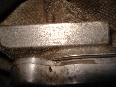

One day I will know the answer to this question for my 2003/C2 car which had a replacement in 2005 sometime and now has the engine number:
M96/03AT 66566759
Mine's only 1,201 units apart but slightly earlier.
post-86549-0-54243500-1432365802_thumb.j
