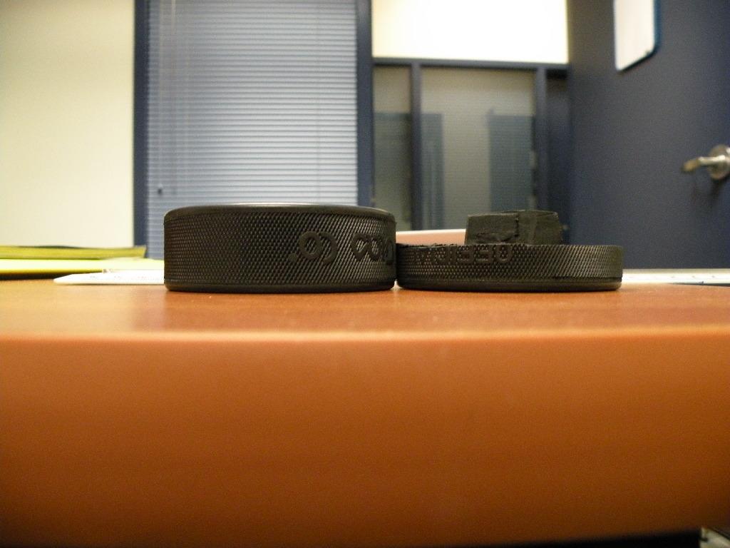

Creekman;
From a hockey puck, I made a cut-out last night for my 996's jack point. I attached 2 pics to show you.
I made the cut-out large enough so the whole puck stays up until I can center the jack under it. It works well!
Hockeys pucks are everywhere here in Canada and you can get them for a buck at Walmart. Any community with a skating rink should have those avail even in Texas, I assume. Good luck with your MaxJax.
