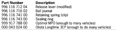

The part you are looking for is 996 116 712 04. Below are all the parts that need replacing per the TSB:
The engine does not have to be dropped to change the clutch.
I believe the "00" part number is the orginal part and should not be used. The lastest number is as listed above. Make sure you use that one. Call dealers if you want verification of the latest part number.
