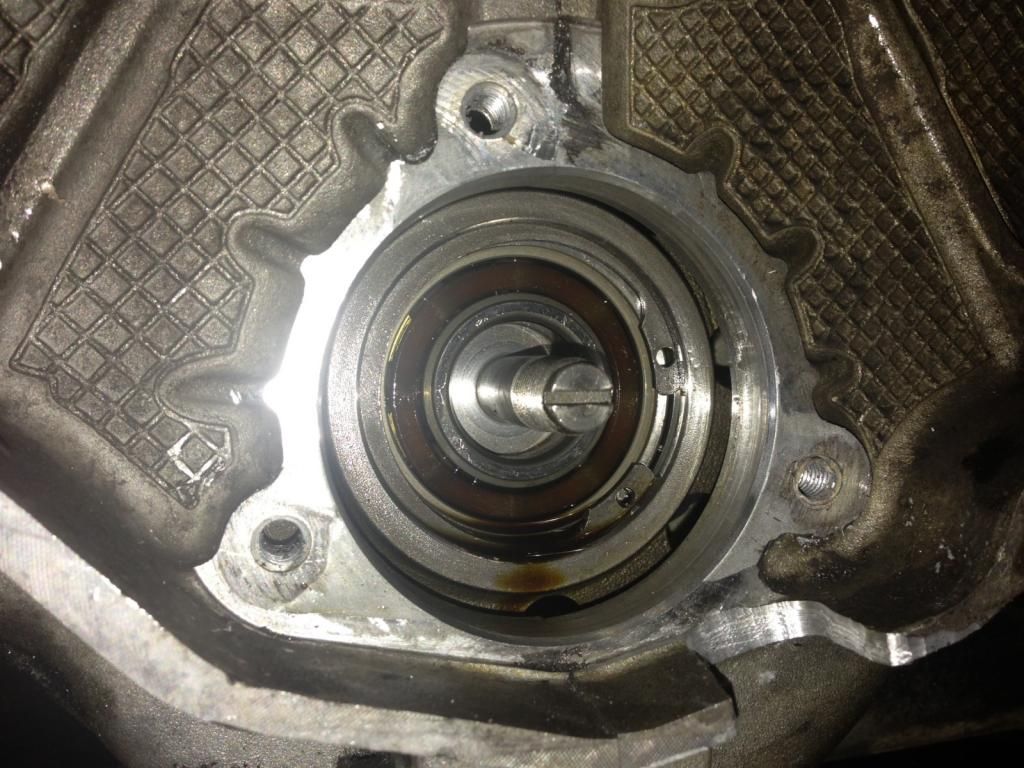

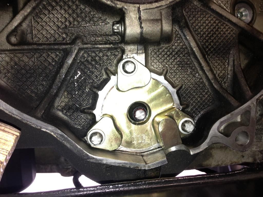

LNE may not want people to put a Direct Ol Feed (DOF) Kit on one of the LNE bearings, but I assure their readers that the DOF can and is being used by many Porsche owners who had replaced their IMS bearing with the LNE but who still felt uncomfortable with the lubrication or lack thereof of their newly installed IMS ceramic bearing.
Here's proof of the last one we installed:
With the tranny, clutch and flywheel removed
With the flange removed you can clearly see the LNE bearing
We left the LNE bearing in place and installed the DOF which will now properly lubricate it

Thank you for your photo Pedro. The last photo shows exactly why you cannot use the DOF with the LN kit.
There is not enough thread engagement for the center nut with the DOF and the center bearing support in the LN Engineering IMS Retrofit. Installing one with insufficient thread engagement will not allow you to accurately torque the center nut. And even if you do manage to torque it, with subsequent heat cycles the top threads will likely not hold the torque. We've already determined an improperly torqued center nut - either too tight or loose will cause a failure! I hope for your sake there aren't many out there like this.
Additionally, we closely measure and blueprint (and have so for several years) to ensure proper fitment. How does someone installing the DOF know that the flange provided is made to the same specifications as the LN Engineering IMS flange?
Lastly, how can the DOF be compatible with both the stock center stud and LN Engineering stud since they seal in different manners. Our center stud is ground to a precise dimension to ensure leak free operation with the internal o-ring located in the flange. Stock flange relies on a larger o-ring located on the center stud. Lack of an internal o-ring will result in leaks over the long term. We also know this for first hand experience where users damaged the internal o-ring or accidentally removed it. Even with loctite and flange sealant, they will eventually leak and cause a comeback. Again, first hand experience.

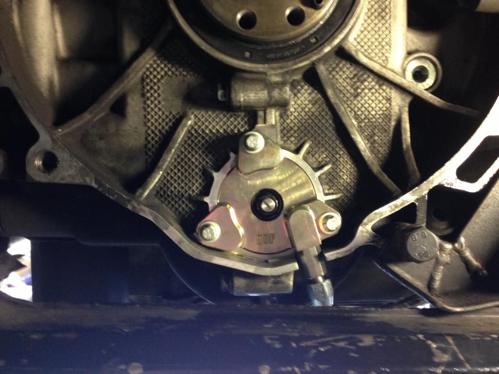

Come on Charles!
You can certainly see that the last image I posted of the DOF on an LNE bearing is during the installation process. The flange hasn't been torqued yet and there's no nut on the flange to show that it's an LNE bearing/flange.
Do you want to see a couple torqued down with the nut on the shaft?
Here you go...
This first one isn't hooked up to the oil line yet, although the notch has been created.
The second image is complete with the oil line connected and ready to reinstall the flywheel/clutch/transmission.
00-boxster-dualrowinstall_zps52797e25.jp
When people order the DOF from us we ask if they have an LNE bearing in place. If they do and want to keep it, we then send them a version of the DOF that precisely fits the LNE shaft and ensures a leak-free life.
Finally so that there's no doubt whatsoever that the DOF can be installed on the LNE ceramic bearing, I can categorically state that that's the combination that is in my own car.
Wouldn't you agree that that qualifies as first hand experience?
