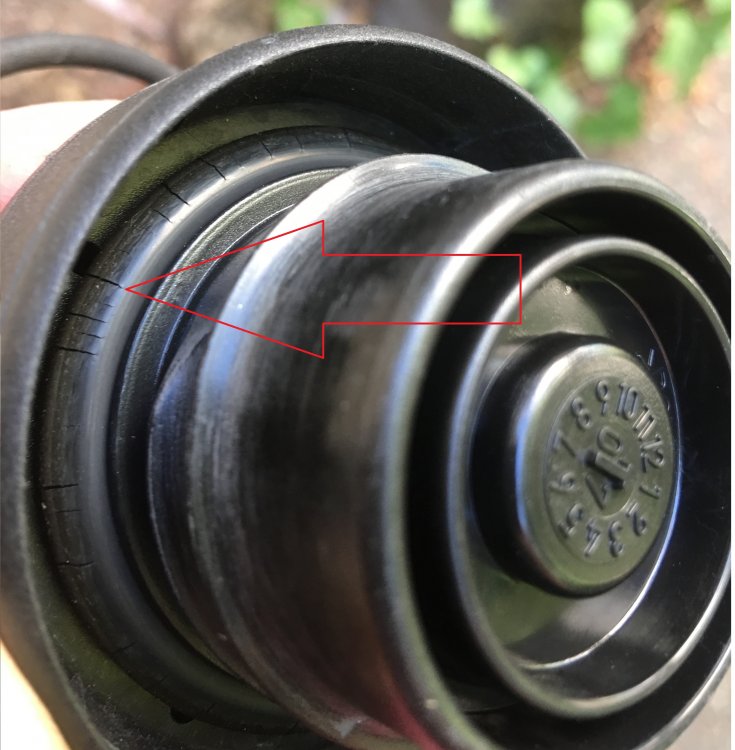

18 hours ago, SpawnyWhippet said:
Seems like my CEL came on with codes P0445 and P0446 due to the cracks in the fuel cap seal (see arrow in pic). Amazing that such a tiny problem causes the CEL to come on. Fingers crossed that there is nothing else to fix. This was a $20 repair so far...
Without a doubt the most common cause of this fault. Nice work!
