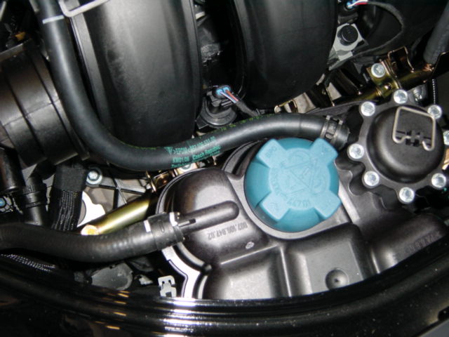

Well, it's my turn.
Coolant tank been leaking slightly, about a quart every week, for about 6 weeks now. Warning light worked perfectly, I now check every few days, and keep topped off every few days.
Typical coolant traces in trunk area discernible once I removed wood liner, of which a part is now mostly mushy/soaked and in the process of drying... :angry:
Does anyone believe the above coolant is compatible with our engine, and could be a safe temporary solution to my slow leak problem until I replace the tank? :lightbulb:
That's assuming that this coolant does not expand as much as standard coolant, if at all, therefore present leak will be minimized.
If so, is it possible to replace most of the coolant without a complete flushing of the system?
I'm wondering is a complete coolant flush is almost as much work/trouble as simply replacing defective tank.
Thanks for any input.
Tony

This makes the task less daunting. TP, thank you for the clarification, it looks like tank replacement is my best bet, done as per your thread/photos.
I was a bit confused at the choices, between 986 and 987 tank, would it be correct that your eBay tank ordered a while ago was a most recent 986 model replacement, and if I order from Sunset now, the 987 wouldbe the best choice and/or most recent update?
This is the one with the whole you pop out?
Thanks!
Tony
