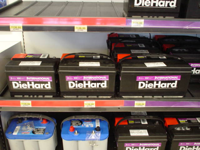

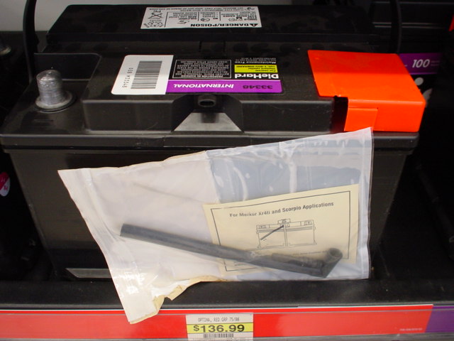

And you only thought I was nuts. Sears DieHard International group sizes 47, 48, and 49, lined up so you can see the difference in length. Made by Johnson Controls which now owns Optima, and Johnson Controls also make the AutoZone batteries. Each of the Sears batteries has the plastic cap for the positive terminal and the plastic bag with the vent tube and adapter.

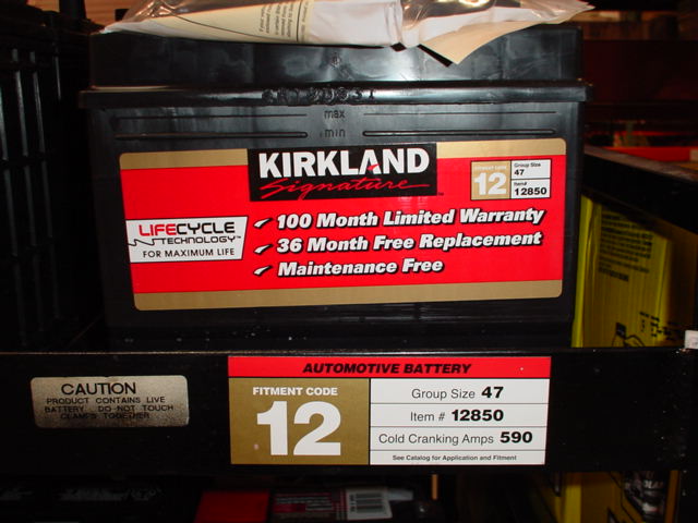

Costco next, as Johnson Controls also makes their batteries. :D

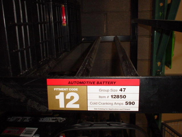

The Costco in Santa Clara has not had the 47 in stock the last few times I have been there. I was there today - still not in stock. There is no sticker on the racks for a 48.
But I did buy a 25 for my Toyota truck. The last one I bought several years ago had a 2 year free replacement warranty. The one I bought today is 3 years.
Update. I was at the Costco in Mountain View today and they had plenty of 47s on the shelf. No sticker for a 48.

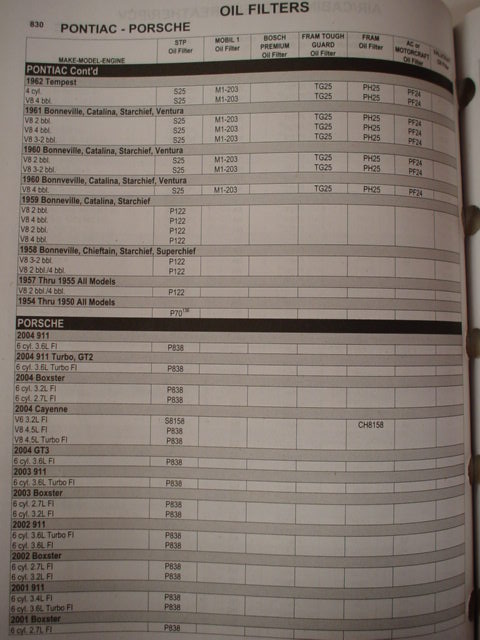

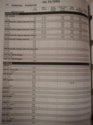

STP has an oil filter listed for a Porsche. Nothing on the shelf. Would be interesting to see who actually makes a low production filter with the STP brand on it.

Sorry to bring an old thread back to life, but I just installed the Duralast battery from Autozone in my 2003 Carrera. I connected the new vent tube with adapter to the old vent tube with adapter. Did I need to cut off the old vent tube adapter and connect it straight to the tube? Thanks for the help.
Vik
Share this post
Vik
Yes. http://www.renntech.org/forums/index.php?s...ost&p=14457
Share this post
Vik
:P
Thanks! I didn't see your post. The old adapter just slid off and the old tube fit right into the new adapter. Thanks again for your help.

Well, those Kirkland folks must be driving Porches.
Gilroy Costco. Both 47 (53.99) and 48 ($62.99) on the shelf.
Santa Clara Costco still does not have a sticker for 48. There is a sticker for 47 but the shelf was empty.
Update on Santa Clara/Coleman Avenue Costco. I was there yesterday, January 12, 2007, looking at tires for my truck. There was a sticker for the 48 and about 4 on the shelf. For the 47 there were about 5 on the shelf but no sticker. Some of the vent tubes in the plastic bags were missing.

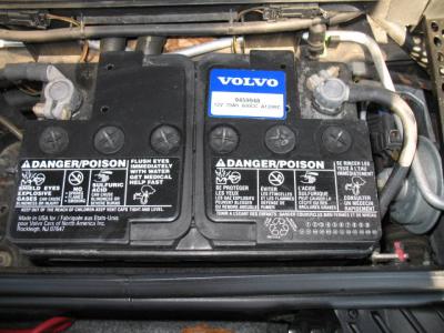

And here comes Volvo in a Boxster....
It says made in USA for Volvo Cars of North America. 70 amp hours. 600CC. Looks very much like the Moll.

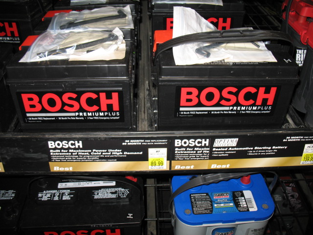

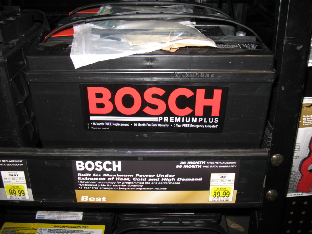

No new battery pictures in 2 weeks, so I went to my local Pep Boys for a Toyota part and brought my camera just in case.
Bosch branded (hecho en Mexico). I am almost positive these Bosch batteries are made by Johnson Controls.
First picture has the 47 and 48 next to each other.
Second picture has the monster 49.
All 3 had the vent tube and all 3 were priced at $89.99. 3 year free replacement warranty, and pro rated after that.
Share this post
The huge 49 is the same price as the smaller 48 and the yet smaller 47, $89.99. Bring a forklift - that 49 is big.
I forgot to look to see who makes these Bosch branded batteries. Poking around the internet it looks like Johnson Controls uses the Bosch name for Pep Boys, like they use the Duralast name for Autozone.
If you see a Bosch look at the paper instructions for the vent tube and see if it says Johnson Controls.

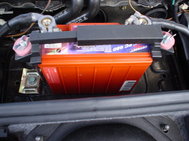

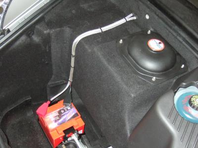

How about the Odessey battery? lightweight, no fluids or vent, better performance and 10 year guarantee. I've had one in my GT3 for 2 years. Pulled the anchor old type and mounted this on the front floor.

Tool Pants,
I have no association with Odessey other than being a satisified customer.
With all due respect, these batteries (Odessey) have one of the highest power/weight density (< 12 lbs for the battery I use, and less for the next size down) of any commercial/military battery. I've been using this one for two years (my third winter) with absolutely no problem at all in my GT3. Actually I could have gone with a smaller size and been OK. I've read in the car trade mags that the high end car manufacturers are finally going to this technology battery. These are actually dry cell design not wet cell, no gas venting and can be shipped in the normal UPS etc. way. Punch a hole in the side, no leakage. I fail to see the impractability, could you elaborate please.
Share this post
Why not keep it mounted in the factory battery tray? Just wondering. --Brian
Share this post
Brian,
If in fact you have to have some weight in a vehicle, it's better handling wise, to keep it as low as possible and in a Porsche forward is better than rearward. In this case you are moving a much lighter battery, down as well as forward. The old battery was, I think 20 some pounds heavier and placed high under the windshield, two worst cases. Getting rid of weight is probablly one of the best, cost effective ways, to improve performance. No promotional BS here you can calculate the actual gains, HP/Lbs.
Share this post
Ok. Noticed that the photo on the tool pants post is an Odyssey pc680. Checking the web it shows it is a replacement for a motorcicle battery.
!Are these batteries so good that a motorcicle battery can be used for a Porsche?
Share this post
hi8ha,
I'll say it again, I've been using this battery in my GT3 for going on 3 years, sitting for months at a time in below freezing temps, and have had no problems of any sort. Not sure I understand your question, cars, trucks, boats, motorcycles, atv's all use batteries and if they are 12 v they will work in each other to some degree or another. Because someone calls a battery a motorcycle battery or is used in a motorcycle doesn't mean it can't be used in a "Porsche or a "Ford". There is nothing special about a Porsche battery other than it's too big, too heavy and in a bad place in the car. You can save about 20 pounds and relocate the remaining weight to a reasonable spot and get a 10 year guarantee along with a battery that outperforms your anchor for about $100. Your choice.
