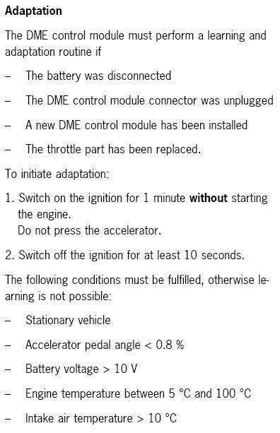

With all DME systems, the engine must run for several minutes before the engine control module can
relearn the idle speed and mixture adaptation values! After the battery is connected.
With the DME ME 7.8, it is necessary to carry out a learning and adaptation routine as described below:
1. Switch the ignition on for 1minute without starting the
engine. Do not actuate accelerator pedal.
2. Switch off ignition for at least 10 seconds.
