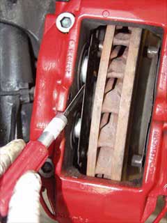

Important Notes: Pull out brake pads together with the vibration dampers. If this is not possible (depending on wear of the brake pads), use a spatula to detach the vibration dampers from the brake pad plate before removing the pads. In both cases, first set back the brake pads as far as possible with the piston resetting fixture. If necessary, first remove some brake fluid by suction from the brake fluid reservoir.
Can someone explain this more clearly? I've never worked on a caliper before, so am having difficulty visualizing this. Also, what is a "piston resetting fixture" ?

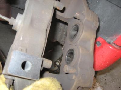

All you are doing is pushing the pistons back in (slowly and carefully) so that new pads will fit into the calipers. This action will push brake fluid back into the brake fluid reservoir (in the front trunk) - so you need to be careful that it does not overflow.
Unless you have a bad piston seal there should be no reason to bleed the brakes after a pad change.
Once you are done and ready to drive the car - start the car and press the brake pedal several times to seat the new pads. follow the pad manufactures recommendations for "bedding in" the new pads.
OK, but I'm another guy who's never done fixed caliper brakes before. I always used the big c-clamp to push the inner pistons (the only pistons!) back in. How do you supply leverage on the old pads to force the pistons back in without scratching the nice finish on the calipers?
Jeff
You can just use a rag folded over 4 times or so. Pushing them back in is not that hard. In Greg's picture above he is using the pliers inside so that when he opens the pliers it pushes both pistons back.

Ok, so last night I tried pushing the brake pads away from the caliper so that I can take out the pads and the dampers. I think I was able to push them all the way in but they still won't come out (they are JUST a wee bit longer than the gap.) Since I need to replace my rotors too I'll be taking off the calipers too, so thought I'll take the pads off then. All seemed great but I noticed that Lizard1 mentioned that you should clamp the brake line! I don't want to mess with the hydraulics (more time), so I thought I'd simply take the calipers off the rotors WITHOUT disconnecting the brake line. This is ok, right?

The only thing that I could add would be that even after you reset the pistons (the channel locks work perfect) the vibration dampers are stuck to the old pads and require a bit of careful prying to get them seperated which i found is the only way to get the pads out. After that it is smooth sailing.
