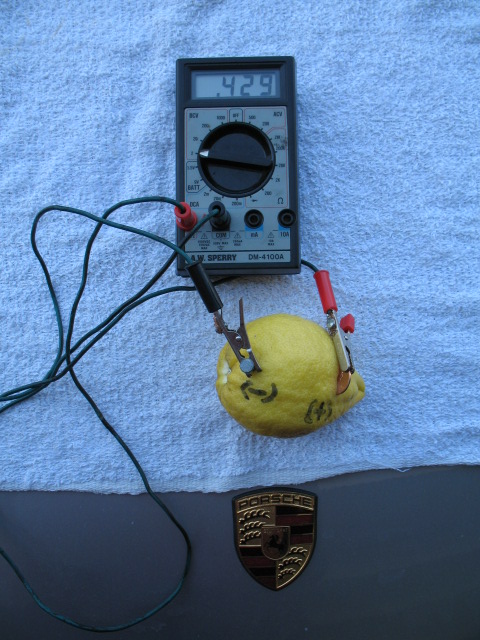

I was picking lemons in the backyard today and there was a funny looking one. Tought it might make a good battery.
A galvanized nail, a copper penny, and a digital volt meter. The penny is positive so I marked it (+). The nail is negative so I marked it (-). Did not want to fry expensive electronics.
I expected to see about 1 volt but the meter said .429 volts. Bad juice I guess or I did not squeeze it enough before I stuck in the nail and penny. I would therefore need more than 24 lemons to get 12 volts, but I had hoped to make a lightweight battery.

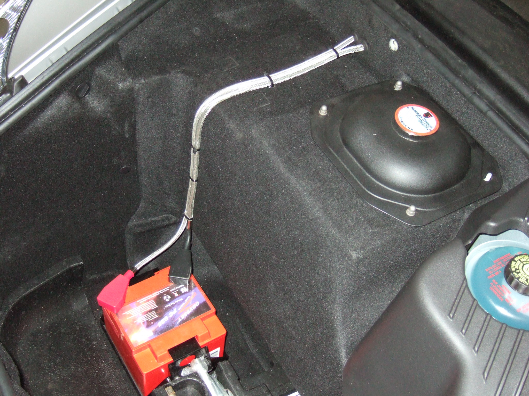

How about the Odessey battery? lightweight, no fluids or vent, better performance and 10 year guarantee. I've had one in my GT3 for 2 years. Pulled the anchor old type and mounted this on the front floor.
Why not keep it mounted in the factory battery tray? Just wondering. --Brian
Hey Ray - can you tell more about how you mounted the battery in this position? - ie cables used, mounting hardware and place fastened, etc. Thanks
Tough question, I bought bits and pieces from a few suppliers. The battery is mounted in a battery box specifically for this battery, Summitt I think. On rubber isolation mounts from Mc master Carr. The cables were from Speedway Motors. Drilled 3 holes in floor, didn't really need 4, to put the isolation mounts in and then mounted the battery to them. Used a hole saw to drill two holes in the fire wall and ran the cables through them using rubber grometts from Mc master carr. And some misc. cable ties, screws, bolts, etc.
I just bought the battery and box and figured out what I needed from there.

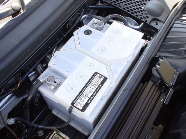

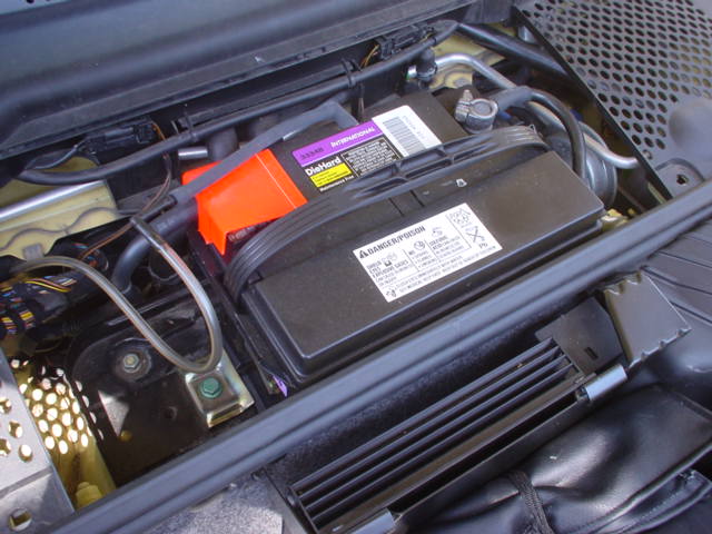

First is an Interstate in a 2001 Boxstir. It was missing the vent tube adapter. The tube in my hand and the black plastic part went into the original Moll battery.
Second is a Sears International in a 1997 Boxstir. It had the vent tube adapter.
Third is interesting, on a 2003 Boxstir. Years ago if a battery was replaced under warranty Douglas was used by the dealerships as a replacement. It is easy to tell because it is all white.

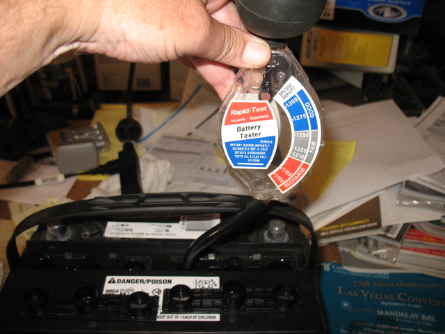

So for #3 I pulled the caps and put it on the charger. Checked with my hydrometer and 1 cell was much lower than the rest. To me that means there is a short in that cell which causes a drain. On the 10 amp charger all cells except that one would bubble.
Back to Autozone for them to test #3 on their machine. I ask him if the machine does a load test. No answer. I don't think they know anything other than how to push the start button on the machine. The guy says the battery is low, whatever that means. I saw a load test button on the machine but I do not know what button he pushed.
Now I have to talk to the manager. He says the battery needs to be charged so a load test can be done. Told him it had been on my 10 amp charger for several hours and I drove it over from my house which is 5 minutes away. Told him I used a hydrometer and one cell was dead. But that if they wanted to charge it then go ahead. Then the manager said I was too much trouble and to pull the battery from my car in the parking lot and it would be replaced under warranty.
So I did. Pulled the battery. Showed him my receipts and when he went on the computer he saw that I was on #3. Told me that the warranty would be prorated. Told me I would get a $20 credit towards battery #4. #1 was $59.99. Now Autozone wants $84.99 for the battery. With the $20 credit I would pay 39.99 for #4 if I wanted it. If I went to Costco for a new battery then it is $53.99. Thought about Optima and all that stuff.
While I was waiting I saw a pallet of defective Durlast and Jumpstart batteries at the rear of the store behind the counter. Wish I had taken a picture.
To make a long story short. I have Duradud #4. At least it is the latest red top racing version. So I put some mustard in #4 when I got home. Acid level was a bit low. Put it on my charger and the charge was low. I was going to tell the manager to do all the tests they wanted to to on #4 before I put it in my car, but it was time for me to get out of town.
