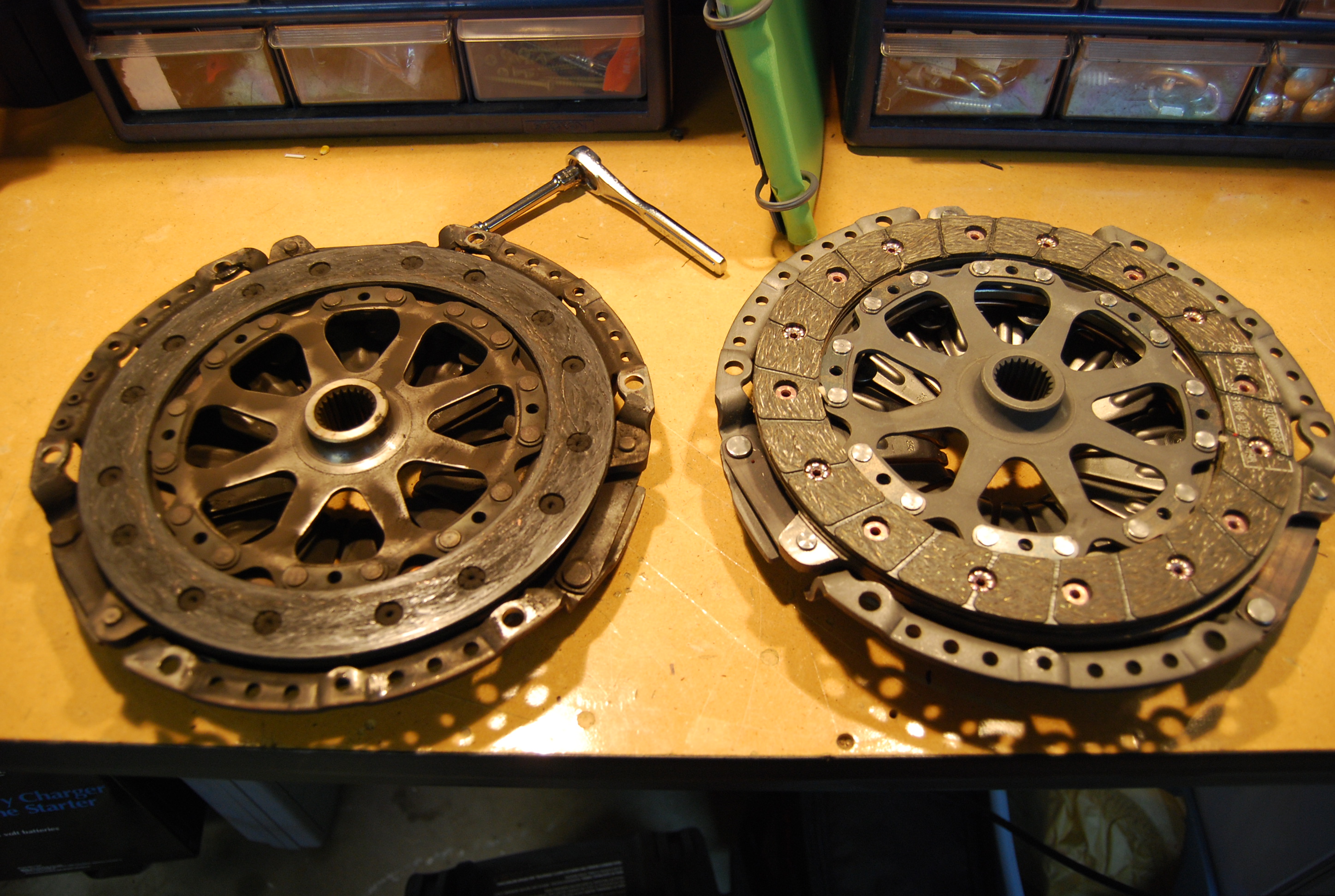

I agree with Loren that the RMS DIY provides nearly all the instruction you'll need. He also gives excellent torque recommendations - follow them. I just completed a clutch/throw-out bearing replacement on a '99 996 C2. Unfortunately, I didn't photograph every step. It wasn't that difficult IMHO, but I have many years of auto mechanics experience. I did it with the car on floor jacks, only 14" of clearance, in 5 degree MN weather and no fancy equipment. BUT, one big word of caution...be very, very patient. If this is your daily driver...forget it. You'll never get it done in a weekend if this is your first 911 clutch replacement.
Some of the bolts are extremely difficult to remove. Especially, the top bolt of the flywheel housing. The clearances are extremely tight unless you drop the engine/tranny. I had to cut a box end wrench in half to tackle the job. Also, I recommend shorty ratchets (about 3") to finish the job. Once you get the bolts off an average physically fit guy can manhandle the tranny out of it's tight cradle. At this point removing the clutch is super simple...provided you have the right tools. Check out the old clutch vs new...after 80k miles it was very worn. If you've gone this far you might as well change the rear main seal too. Again, it's not difficult if you're patient.
Since you have the tranny out this is the perfect time to change the fluid. Just do it! I found installing the tranny was a bit more difficult than removing it. After all, you're fighting the forces of gravity. But, I did it myself with just a good floor jack. Once installed reconnect the shift linkages, electrical connections, etc. I noticed quite a few posts about bleeding the hydraulic clutch. Again, it's no biggie IF you get the right tools. I use a 3 ft tall super sucker vacuum pump. Had no problems at all.
In summary, this isn't that difficult of a job if you have above average mechanical skills. Make sure you have all the right tools, especially a good torque wrench and tight space ratchets/box end wrenches. Good luck!
