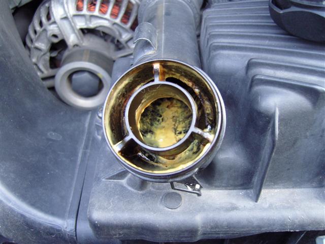

I'm breathing again ! :jump: I did review all the engine removal and dismantling manuals and read all te topics about "intermix" on this forum, and I was cold and warm at the same time ! Fortunately I'm missing most of the symptoms of a severe intermix problem.
Nevertheless, I will monoitor the evolution of any futher mayo in the oil filler cap and we will take in the coming weeks the car out for a couple of longer trips. Many thanks for those re-assuring words! I'm adding a picture I took when I removed the filler cap. Cleaned it up now! Rgds..
That's a little more than what mine looked like, but not too different. It's probably not intermix, but just normal condensation. Once I cleaned it and stopped driving the car for a couple miles without ever getting to operating temp, it never came back. Now I only drive the car if I intend to warm it up to operating temp, even if it means going "the long route".
If you want to be certain it's not intermix, have a look at your coolant, what does it look like? If it looks mayonnaisey too, then there is a definately problem. With classic intermix, the oil will mix into the coolant system, but the coolant rarely mixes into the oil system.
This is not an uncommon occurance during winter months - I'm a big believer in taking the car (any car) for a good long run (say 50 km) at highway speeds every week or so. Even revving the engine to 5-6000 rpm occasionaly during a 20km urban drive does not generate much extra heat in the system - afterall, its only for a couple of seconds, then its back to the mundane 3,000 rpm chugalong for the rest of the journey.

We drove the car longer and since then and about 1500km further down the road, there were no new signs of white/yellowish deposit anymore in the oil-filler pipe. I guess no-one needs to see a picture of that !
Many thanks to the members for their re-conforting words.
Given Tim's travails I can understand his pessimism, but if you are not seeing contamination in the oil (on the dipstick) or in the coolant (look in the tank) I think this is just the common gunk from cold weather. Since I bought my car in 2000 I have gotten this residue in the filler neck during the winter. When I had my intermix it was way beyond what you see here. It would be worth draining the oil to take a good look at it.
Ditto on draining the oil. That will easily tell the tale. Also had ugly stuff on dipstick. Believe me I hope its nothing. I have 996 on blocks in garage with engine out. Still not sure what to do since my cylinder heads are not recracked. Cheers!
