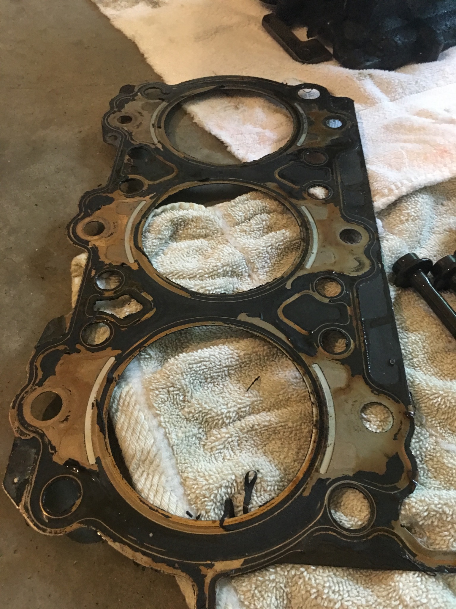

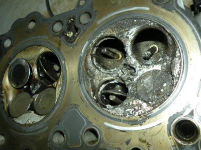

Back in May I found oil in the coolant in my 1999 C4. 123,xxx miles, water pump changed @ 96,xxx miles. I sent an oil sample to Blackstone and it showed no water, but traces of sodium and potassium, indicating minor coolant contamination. I flushed the system with distilled water and ran the car a bit to flush... Now I've got milky oil. $hit. I dropped the engine and pulls the heads. There are no obvious cracks, but it looks to me like the head gasket on driver's side was allowing the mix. Thoughts on the pics??? For those who had intermix and fixed heads, what did you do about rod/main bearings??
