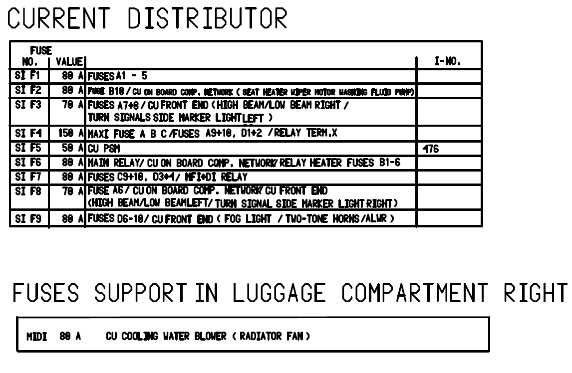

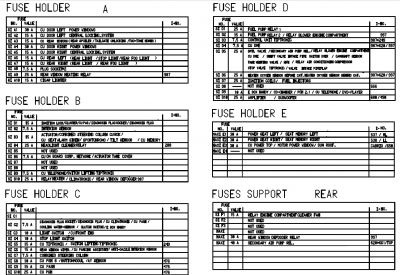

 OK, here is the entire fuse system listing for your car:
I would take a look at fuse holder E, fuses 1 & 2, which are 30Amp units for the power seat controls.  If no fuses are out, I would again suggest having the car scanned to make sure they are actually activated.

Loren,s suggestion that the fuse box is behind the glove could be the answer, trouble is I cant get at it with out taking the glove box out, will investigate further, Thanks again.

I would take JFP's advice and get the coding checked. The heated seats on a 987 are connected to the control module, and don't go through a fuse other than the current distributor. If that had blown, there would be other issues.
