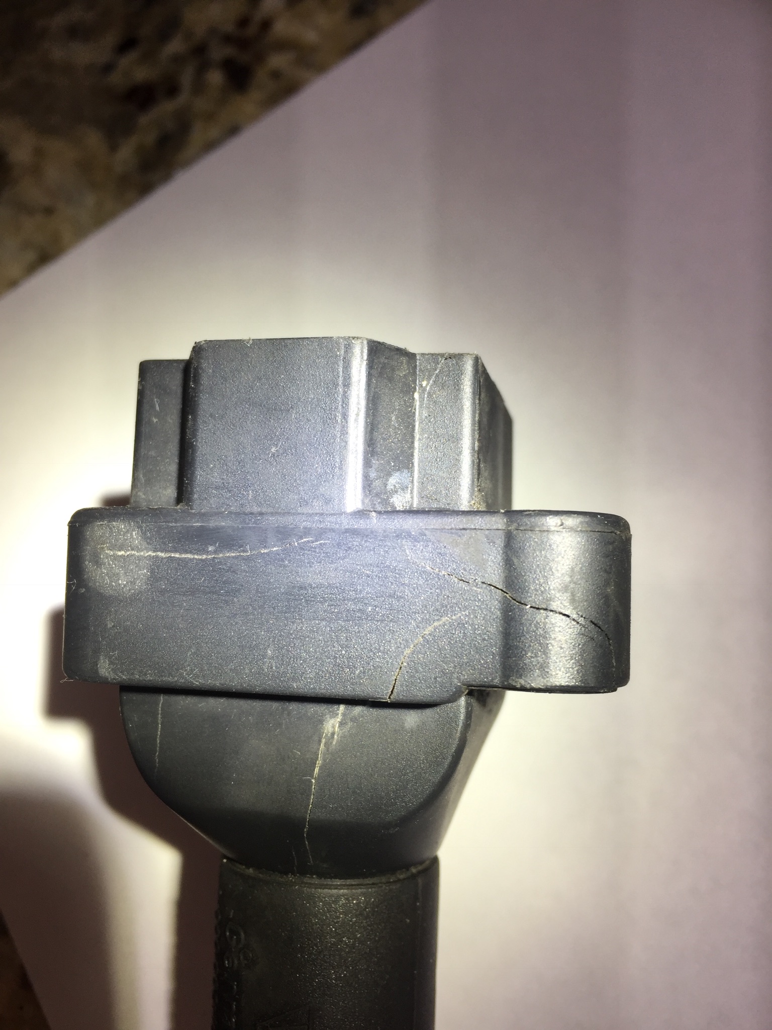

Actually, it is pretty high based upon experience.  I would pull the coils and look for small cracks, the give away sign that the coils are on their way out.
JFP is one of those who knows! The cost to pull the coils is your time.
I just changed mine with 44,000 miles on 'em and three of them had huge cracks, two had hairlines, and one looked ok. I logged misfires using Durametric in two cylinders frequently and three other cylinders less frequently even though it never threw any codes, the engine just seemed down on power and misfired and ran very rough only a few times while standing at stops. Even without the cracks I was planning on replacing them simply based on the misfires logged by the computer, I figured it was time.

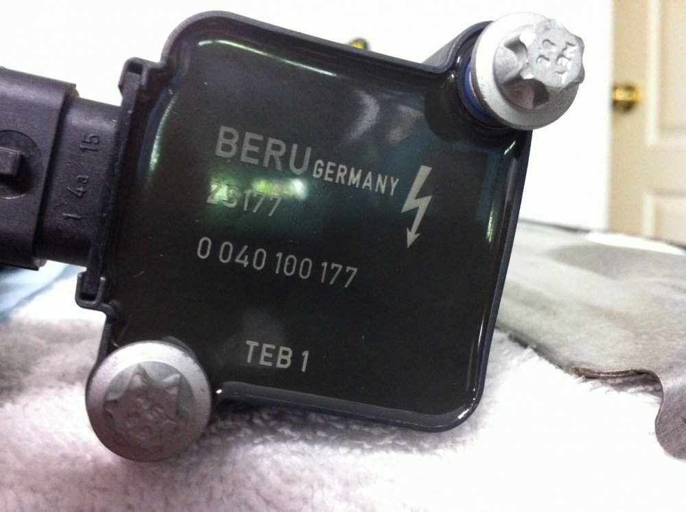

After checking original coils, I'd be shocked if they weren't toast, I would get new coils, screws, plugs, dielectric grease (for the boots and plug porcelain as indicated on Beru's site), and a really tiny dab of anti-seize on the plug threads. I put a small amount of dielectric on the outside body of the coil's electrical socket (on far left in photo) to aid in slipping the connector cover back over the socket, I couldn't make it work otherwise.
edit: this coil is the latest and is the part that my local Porsche dealer keeps in stock for Boxster, Cayman, 911 and covers many of the years. When I saw that it didn't have Beru on the coil (it's stamped Beru on the boot), I reconfirmed with Porsche that this is the correct part because searches didn't know this part number.

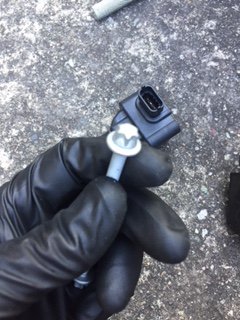

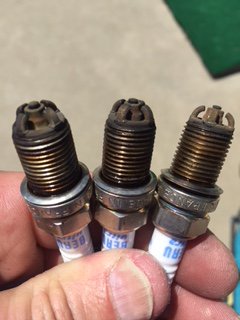

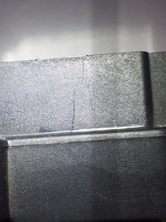

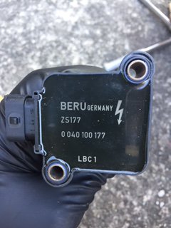

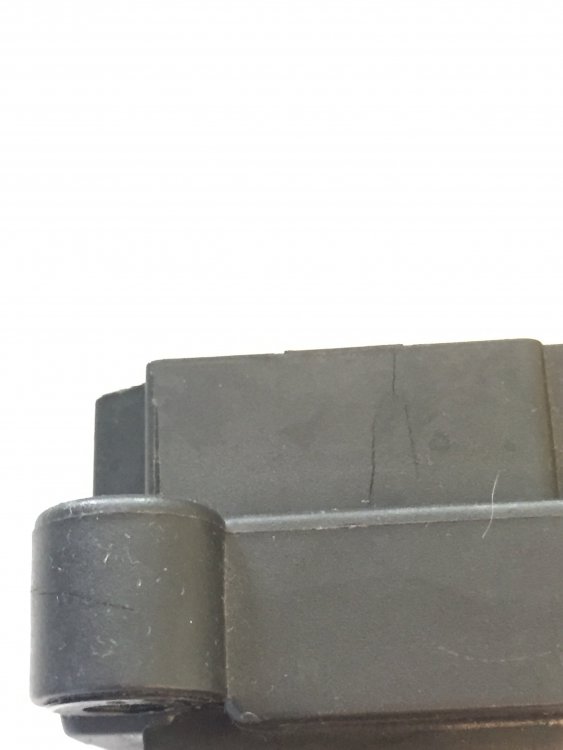

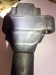

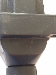

uSo I took the rear of the car apart (person who designed this should be shot), to access the coils and plugs.  So far, have only done bank 1. This is what I found. Look like there are some cracks. Hard to tell if they are fatal cracks or just surface issues.
There are more pictures of the cracks, but for some reason, I get errors loading them.
These are also also the plugs that I replaced.
Edited by TNT79Bronco
Images of Cracked Coils from Driver's Side
IMG_0650.JPG.12f68aca5a935975bd25ec9635ec8c42.JPGIMG_0651.JPG.0aa14ccaf04a41d948cdb53f72f2fe80.JPGIMG_0652.JPG.6fa41bf653ad6008e6937dcf2167dc25.JPGIMG_0653.JPG.af8096d5c7021fc9abb84524fae08396.JPGIMG_0654.JPG.1baebf154bbef363d7fa43cba97373d0.JPGIMG_0655.JPG.61bda217f18d2d1f1759b0491ca5a0a6.JPG

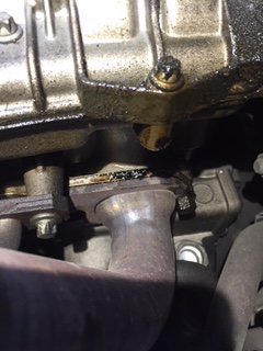

Oh...once I got under the car, I confirmed my suspicion, which was that I had a valve cover leak on the passenger side.  I can smell oil, when I drive and I notice that I tend to use oil at a semi increases pace.  I expect some smell and loss of oil, but it is evident that I have some leakage.  This is a replacement engine from Porsche, installed while the PO had it.  It suffered some type of catastrophic engine failure.  Not sure which one, but it was replaced under the class action lawsuit.IMG_0659.JPG.0ef52ede9cbbf3ff477528b78e0c7d3c.JPGIMG_0660.JPG.0d7996e065a4bb14b80eb412e2fc29ac.JPG
