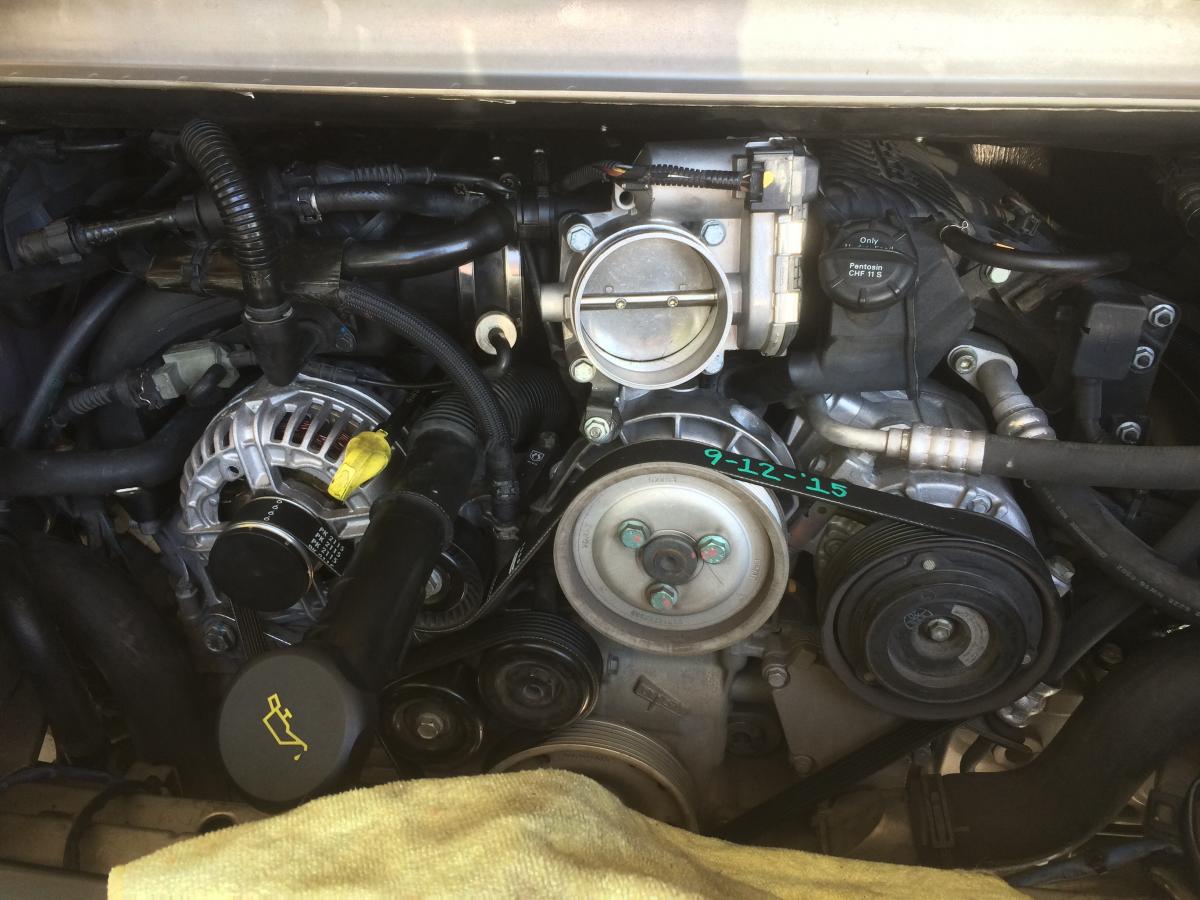

Here's another "I did it!" success post!
Many thanks to: Hobbes for the original DIY AOS post; to Ahsai for his post ('MkII AOS DIY Sanity Check') regarding the procedural differences for the MkII engine; and the many other users who have posted about their AOS replacement experience .
Especially thanks to Loren et al who created and maintian this resource!
If it hasn't already been done, I would suggest that the link to Ahsai's post be added to the Hobbes original DIY post. The search function didnt return Ahsai's MkII post; it was just 'blind-luck' that I found it while wandering through other post.

Just replaced mine this past weekend. Took 7 hours start to finish. I have an 03 996.2. I found loosening the AOS first was easier before trying to get to the last manifold bolt. Assembly didnt go as well because some bolts weren't lining up. But I got it done.
